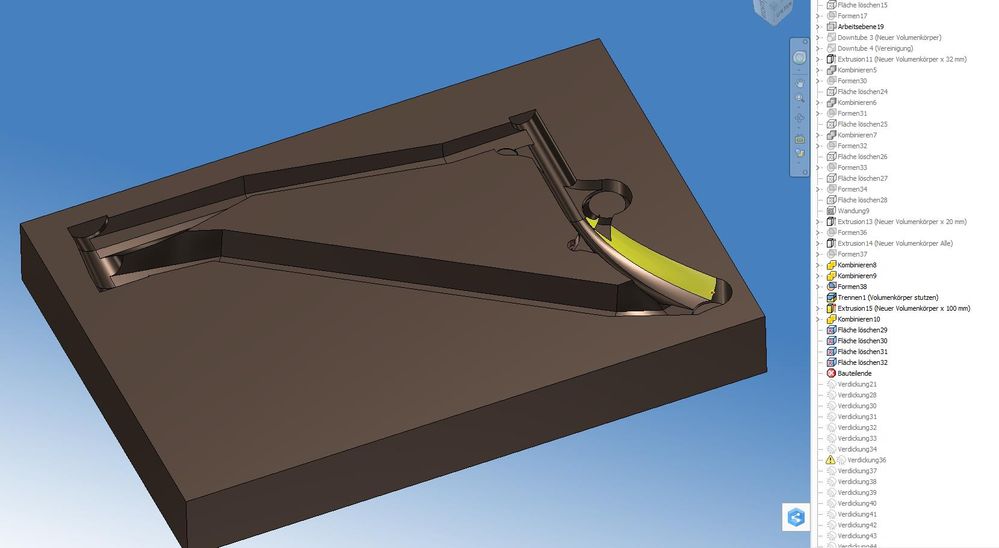

Using thicken surfaces, I've almost fully modelled the mould. However, I'm getting a lot of resistance from inventor with dialogue reports stating 'unable to perform bolean / remove faces / large topology change...' Sometimes by combining various faces or thickening one at a time I can make a little more progress, but I am discovering faces that simply wont thicken once others have been, and that I am required to try a loft between thickened faces to fill in the gaps (which also doesn't always work). However, this file is 80% what I want it to be, short of a few internal things to resolve. Can I get some assistance on discovering what is stopping the final few surfaces from thickening?

WHolzwarth
Your basic solid has tiny gaps. Look at the yellow region.
This needs to be cleaned up before trying a thickening.
Walter Holzwarth
Message 19 of 19
Thanks very much for looking - but I've no idea how you could tell where the problem is... I've done some inspection of the model and I don't see anything, and because that whole area is just a loft, I'm not sure where the gaps would be.
