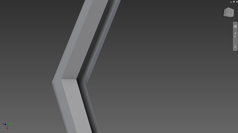

This is likely to be another 'how many ways can we skin this cat' type of thing. I'm making a small frame that will have another piece inserted into it during the print process. Simplified, it looks like this:
And a closeup of the inset part:
When I'm making this, I break it up into three "layers", the bottom part, a center (which is smaller dor the inset) and then the top, like this:
The bottom and top get an inner chamfer and all three together get the outside rounded with a fillet. For the most part, this works. Especially when the bottom layer has other stuff, like sometimes instead of it being a six sided frame, I will fill the hole with some sort of design, then the center one and the top one which are just a six sided frame.
However, the one thing that annoys me is if I forget to do something on that bottom layer, or if I need to change it a bit, many times it affects the next two layers to the point where I need to completely delete them and redraw. So my question is, is there a better way to do this? Or what I'm doing the right way to go about it, keeping in mind that the bottom layer can be different in the middle, but the outline is the same as the rest.

In the above example, I purposely left out a small loop at the top of the frame. Think of a loop that you'd use to run a split ring through or lanyard. When doing it in the three layers, I have to create that loop on each layer to encompase the full thickness of the frame (and later use a fillet to round it off.) And since each layer is dependent on the one below, if I make a mistake, or I change the shape of the loop, or even the shape of the frame itself, Inventor starts telling me it has unresolved dependencies and what not. Usually I just delete those upper layers and redraw them again.

For what I'm doing right now, they're 6-sided. Could be 8, could be less, but no less than 4. And the rip is always centered. As for the chamfers, they don't always have to be 45 degrees. In fact, the original test I did, the center piece was 1mm while the top and bottom were 0.9mm, which made the chamfer at a different angle. So that's a bit of a variable based on the design.
The assembly part is 2 pieces, this frame, and the insert that goes inside. When printing it, the inside piece is done separately, then the frame is printed. The printer is set to stop at a specific height (bottom layer + center layer heights), the insert piece dropped in, and then the printer continues to print the top part of the frame, encapsulating the insert's edges. And with the last test print, the layers were 0.9mm, 1mm, and 0.9mm for a total tickness of 2.8mm.

Ok, trying to edit the updated file you gave me. This has to be something wrong on my part but when I go to edit Sketch1 to add the loop (to hang off of), as soon as I exit that, the extrusion is no longer right, the loop hole isn't there. I don't know how to fix the extrusion profile so it knocks out the loop. So my usual course of action is to delete the extrusion and recreate it, however when I do that, Sketch2 loses its constraints and I have no idea how to fix that.
This is what I mean with 'if I forget to do something early on', I don't know how to recover/correct the subsequent steps after this.

The goal is not edit the model in the "traditional way", but simply change parameters.
Save a copy of my model and study the concept. Change what you need. If you break it, start from a fresh copy.
You saw the video? Understood the difference in construction? If so, you realize that you must have a different approach when executing changes. Why delete the extrusions and do it again? It's better to change the parameters instead. Then, make other operations if you need.
Every time you make a operation (extrude, Chamfer, fillet, etc etc) and place dimensions in the sketch, inventor will add parameters d0, d1, d2, d3, etc etc. You can find these parameters in the fx chart (see image below).you can change the parameters directly in the chart, or editing sketches and operations.
Tip:You can rename the parameters to find them easily.
The first step for you is; learn how to constrain sketches.
Tip: When you open the first sketch, you only have a fixed yellow point. All the geometry that you draw is free in space, you must give some relation to that point (dimensions and/or constraints) to fully constrain the sketches.
After you have solids, you can project edges for new sketches to constrain geometry. that's why yu delete geometry after, will affect operations below. Don't delete, edit instead.
