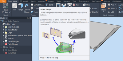

JDMather
@Anonymous
You can simplify your sketches as single arcs.
Then use the sheet metal Lofted Flange tool rather than standard Loft tool.
Be sure to set the Output to Die Formed.

Message 12 of 25
Yes, I want to try make a flat pattern of that part. But I can't for instance convert it to sheet metal.
There is an error: "This model cannot be converted to Sheet Metal because it contains features that have created multiple bodies. In order to convert to Sheet Metal these features must first be removed".
I wanted to isolate this part, but my Inventor can see it only with connection to pipe.
I can see a Thicken1 option in your browser, you first apply a thickness and then in sheet metal defaults you set this thickness to make a proper flat pattern?
@salariua

salariua
@Anonymous I have indeed used copy on the inside surface and then thicken the quilt to a measured thickness of your model.
I don't have access to 2013 here and I won't for a couple of hours but I will do a screencast in 2015 and hope it's close enough for you to follow in 2013
Ideally, you would want to derive the model into separate parts and not use copy as I did just so that all the parts update when the original model changes but it might not be the case here, seems to be a one off.
See this video here

Message 15 of 25
It works, thank you very very much!:)
Have a good day!
Best regards
MRumin
