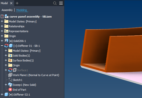

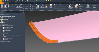

SBix26
Here are the assembly and the stiffener 01 that I modified (Inventor 2024 format).  I copied the pink surface into the stiffener part file, making it adaptive.  I then used your Sketch1 to create a sweep of the U shape along the edge and using the surface as a guide.  I think this is what you are asking for.  The stiffener now more closely conforms to the contour of the pink surface.  It isn't perfect, though-- the sweep has to maintain its shape at every cross-section, so the end is now a small amount (0.1 mm) buried into the curved face.
I also noticed that nothing was grounded in your assembly, so I took the liberty of grounding the curved sheet to the origin, which actually puts the sheet 73m away from the origin point.  I hope that doesn't mess anything else up, but it's important to have at least one component nailed down in an assembly, especially when using adaptivity.

caothanh_dong
Thank you for your solution. This is the result that I need
Could you show me how to add the reference surface (pink surface) to the stiffener part?
Which command do you use the constrain to assign the stiffener to the surface?
