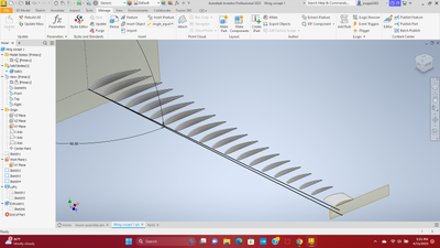

Hi, what is the best way to make each of these ribs an individual part?
I want them to be individual parts so I can orientate them flat on my 3D printer bed.
This was created as a loft between two airfoils, then extrude feature was used to create the ribs.

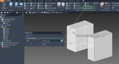

Hi!
Depends on how skilled you are using Inventor.
The newbie way is to copy/paste the file, creating the same number of copies equal to the number of members you need.(i believe is 20)
Open each copied file, use "Delete face" tool, solid mode, and delete the solids you don't need for each specific file.
Then you have each file with the respective solid, after you delete the other ones.

I think it will be easier to duplicate these solids using a pattern:
  1. Create a rectangular pattern
  2. select the variant with the pattern of solids
  3. select a new solid as the result of the operation
  4. select your body in the graphics area
  5. indicate any axis direction
  6. enter 0 in the distance field
  7. enter the number of solids in the quantity field
Expand the folder with solids and turn on visibility one at a time.
Then follow @CCarreiras  instructions to delete unnecessary spaces from each solid (different each time); this way you will get separate solids.
The last step will be to Make Components based on solids (Manage tab).

CCarreiras
Hi Kacper,
To go to the multisolid method, i would prefer to sketch some lines and use Split tool, solid moode, to split the members into solids. Then use the make components, or create Derive files.
I feel it's a more "clean" method than the pattern workaround.
...But, I don't know the level of knowledge @jcuppiii563  has, so i did not mention multisolids, derive parts, make components, etc, since these methods are kind of intermediate/advanced level.
