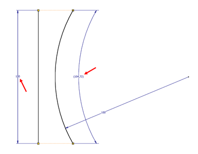

Hello everyone
I am trying to do something that I thought would be simple but is turning out to be pretty complicated.
I simply want to create a "Ring" that will be bent at a uniform radius. This part is to slip over a branch pipe and then conform (roll) to a larger header pipe. I will flatten the part and then export the dxf to have the proper profile cut and sent to our rolling supplier. I have attached a couple attempts to show this.
What I can not figure out how to do is get a UNIFORM ring width. I can create the right radius to match the header pipe but if I create a sketch on a flat plane of the ring, the sides are elongated.
If I create the ring in 2D first, and then bend the part to the right radius, the hole in the middle will be oval and will not slip over a pipe. This hole must be perfectly round on the bent part but when flattened would be oval. The problem with this method is now the sides are narrower.
Essentially on a flattened model, both ID and OD would be oval but there would be a uniform width between them.
Please help!

Hi!
I believe it's this:
Note: the sides should always be slightly elongated due the curvature.
Note: both cuts as Normal.
Check the part attached, and give your feedback.

Hi! Another way to do this is to use Cut Normal option. In your case, you may want to thicken the half cylinder first. Then use Cut command in Sheet Metal (turn on Cut Normal) to cut the sheet. The result should be quite similar but not identical. Cut Normal might be what you are looking for.

Here's your file with a little different solution.  Since a uniform width of the ring is important to you, I trimmed the cylindrical surface first to the ID size, then used Extend Surface to extend it outward by the Side_Mat amount, then used the second trim operation to remove the ID (leaving only the extended surface).  After thickening, I think this is what you are asking for.
The attached file is Inventor 2022 format.

Hi Sandro,
To create what you are after is not exactly a one click away process. Depending on what accuracy do you require - here are two models. IV2020 format. On a top of what Sam and Carlos have offered.
Part1 is simpler to model. Pipe reinforcing pad.ipt is a bit more elaborated.  Both of them would require a weld preparation, depending on a thickness of the pad.
As for the accuracy of modeling itself - I would have evaluated cost/benefit first. The item is nothing but a ruff pad. I would imagine, that the tolerances within +/- 2mm. should be more than sufficient enough for this particular design.

You have to accept one axiom: The arc is always longer than its chord.
Here is a model you have asked for.
Cheers,
Igor.

So I recorded a video presenting one of many potential solutions, the development of which takes 3 minutes with a coffee break.
I think the way you do it doesn't deliver a uniform width of the reinforcing pad all way around.
Yes, because it is mathematically impossible if the washer is to be tangent to a large pipe around its entire circumference.
This whole discussion is wrong. The topic should be approached in the following way:
  1. Determining technological requirements - if you use a specific plant (machine park), you must adapt to it. The designer's duty is to serve the technologist.
    And this was not defined in the content of the post.
  2. Determining functional (and geometric) requirements.
    These, in turn, were defined contradictorily.
    1. If we keep the width constant, we will not get contact with a large pipe around the entire circumference.
    2. If we want to maintain contact with a large pipe - we will not keep the width of the ring.
      This is math. You can't fight it because you can't win it. This must be understood, acknowledged and taken into account in the process. Avoiding and insulting will not solve the problem.
