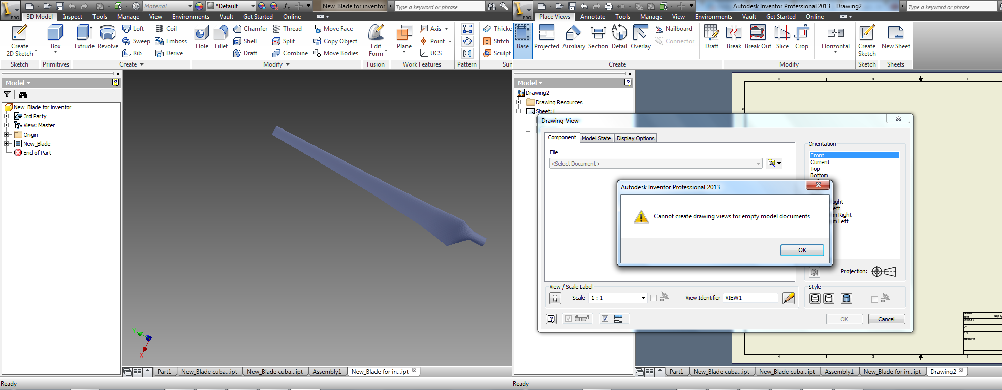

I had designed a wind turbine blade. I had saved it as stl file because the blade softaware not support for 2D drawing. Then, i open the blade in autodesk inventor 2013 and save it again in ipt format. The problem is I still cannot make the 2D drawing in inventor. Can you help me to solve this problem.

can you give me some link to download inventor mesh enabler? and hot to make it in add in for inventor 2013?
here i attach my inventor 2013 mesh feature.

here i attach my inventor 2013 mesh feature...
You attached an image file - not mesh feature.

Just to create a drawing all you need to do now is simply check the "Include Mesh Bodies" in the Recovery Options of the place view dialog box and you can place views of mesh models without using that utility..

Hi! This is a very old thread. Yes, Brian is right. To create drawing views of mesh model, you no longer need to use Mesh Enabler to convert mesh to brep. On Inventor 2018 and later, you can simply include mesh in the drawing and you can also dimension to the mesh directly. It should work just like Brian described.
You can certainly keep using Mesh Enabler (available for download on Inventor App store).

You can create drawings of stl files without having the mesh enabler now by checking the options I show in the image above..

Hi! Yes, Brian is right. As of Inventor 2018, you can simply create drawing views of mesh model without having to convert it to Brep via MeshEnabler. You need to make sure the following option is checked.
Create a view or edit an existing view -> Recovery tab -> check Include Mesh Geometry.
