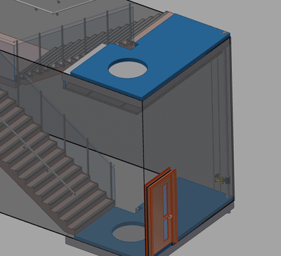

Message 5 of 19
@mcgyvr
The steps I'm following are:
1. Activate the ipj file
2. Change some of the values in a part
3. Open the assembly file. I notice that the "Local Update" function is grayed out (picture01)
4. I'm trying to update it through an iLogic function (picture02) but nothing happens

@mcgyvr ,
The images are only showing that the model doesn't update.
The logic behind the model is the following:
There is the top-level assembly which contains parts and sub-assemblies. The parts and sub-assemblies don't contain any parameters but they take their values from an empty part which includes all the parameters. The top-level assembly contains planes. The distances between the planes are defined by the parameters part.
The way to test if the associations work is to amend the parameters in the part file and see if:
1.the individual parts
2. the top-level assembly
change. In this case after updating the values nothing changes.
I also tried to create a hole on one part and again, the top-level assembly file did not update.
