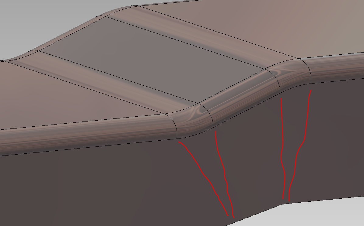

Part of my job is to lay out blanks of 3D models so the blank can be sent out and cut.  Is there a way to convert an Inventor ipt file to a flat blank?  I have tried "convert to Sheet Metal" but Inventor reads the pre-bent part as the flat layout.  I am currently using Inventor 2013. i attached a drawing for an example if anyone can show me how.

For any chance of this part returning a flat pattern you will have to use the Sheet Metal tools to model.  Even then, not sure it will return correct flat pattern.

This part would be produced using a stamping method with a set of male and female dies. You created this item just using the Part template and not the Sheet-Metal template, a different set of tools.
Start with the Sheet-Metal template, create your flat bottom and then the flanges, you might be able to use the rolled contour tool to develop the offsets. Or sketch a line to the outside profile and extrude to surface, then use the Thicken tool to get the proper thickness, then use the Contour to develop the offsets.  I really think that this is outside of the S-M module in Inventor.

Generally here is no difference in creating with sheet metal tools or the standard tools as long as the part is one that can be folded on a press brake.
The problem with this particular part is it is a draw formed die part - not a folded part.
In some cases Inventor has gotten around that with Contoured Roll and some Lofted Flange features, but I am skeptical about this particular part.
If there were some Rips in these areas then the part could be made on a press brake.

Convert to Sheet-Metal, go to Sheet-Metal Setup, set your thickness to the 3.42mm and the model will flatten. As is done in your sample.

The only thing that you may need to change is the k-factor. Each machine and bending process most of the time requires a different k-factor to allow to develope the correct flat layout.

You answered both parts of my question.  Originally i tried adjusting to the correct material thickness and it didnt help.  Now i realize its because i chose a part that would be produced using a stamping method.  I just assumed i was doing something else incorrect.  I can at least use this for 50% of my blank layouts.  Thanks!
