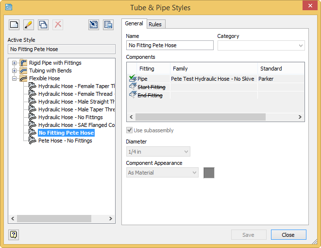

blair
Your Style is still in Imperial, you did change all the units values in the Family Table for Size and Length

petestrycharske
blair,
Thanks for the video.  I debated about posting one and should have.  Yep, I changed the "L" and "PL" to be both be using units of "ft".  Please refer to the images below for snapshots of my CC family and new T&P style.  Would you like me to send you a copy of my CC library so that you can see if I manipulated the family table incorrectly?
