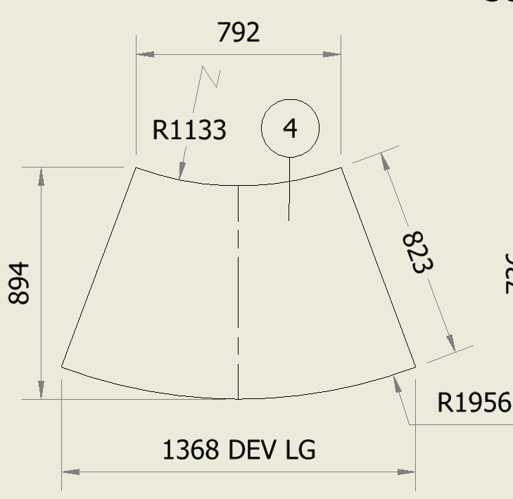

Hi All,
I need some help regarding cone development dimensions. When I do flat pattern, I get the shape of the flat pattern right (see attachment 1) but with my ilogic code which I use to extract the flat pattern dimensions it does not give me the dimensions I need, that is, the development length of the cone and the height of the developed shape as in the attachment 2. It extracts the dimensions see in attachment 1 and give me the result seen in attachment 3.
For each cone development I need to manually edit the nomenclature.
How can I solve this issue so that I get the good development length I require for my cone developments?

Edit:
It appears instead of selecting a line, you can select two points like this and just make it horizontal:
_______________________________________________________________________________________

Hi Yannick,
Thanks a lot, this was exactly what I was looking for.
