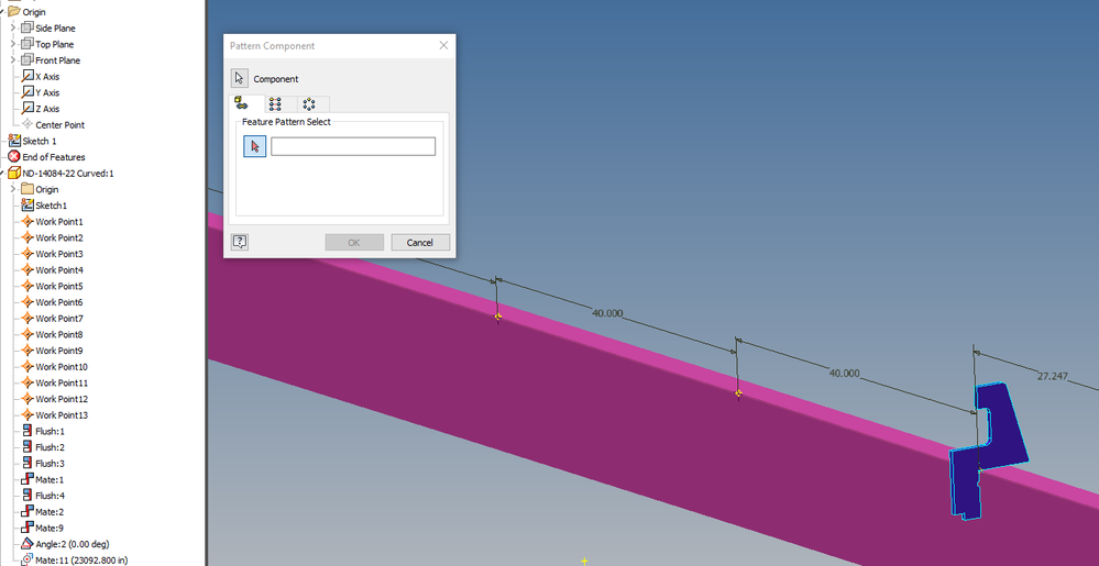

Ok, I am with you.  I did misunderstood that part.  Was thinking at first the work point was just a point.  Have not worked with work points until now.
So, in my part I am patterning the work points and they are not following the curve as show below.
Thoughts on why?
Regardless, manually placed the work points and in the assembly for patterning, still will not allow me to select the work points from the part in the assembly.

Message 8 of 14
TheCADWhisperer
in reply to: Cadmanto
You have a bunch of individual WorkPoints, not a Pattern of Workpoints.

Message 9 of 14
Cadmanto
in reply to: TheCADWhisperer
I know, I did that because the pattern started going astray.  This model I attached was imported.  I created a fresh model similar and am having the same issue with getting the patterned work points to be detected in the assembly pattern.

Message 11 of 14
errr, let me check that again - I don't think not sure if you can use Projected - will need to add sketch curves.
Message 12 of 14
Cadmanto
Yes, setting it to modeling is key.  I got it to work once that was changed.

Message 13 of 14
Cadmanto
Worked, the modeling tab and setting them to directional in the pattern sequence gave it to me.
