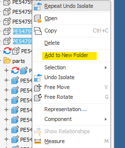

romu51
I use folders to "tidy up" the number of compopnents visible in the browser.
select all the parts you want to groups and RMB "add to new folder". rename as you please.
Message 7 of 9
anthonyzepeda1969
Yeah that was the only other option I originally saw. But that becomes tedious creating so many folders, then if the part changes. Thank you.
