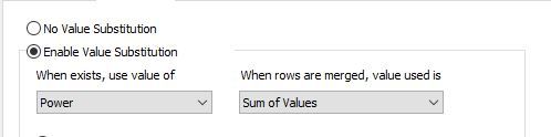

In your parts list you can add the column called "Power". Then format the column > Substitution Tab > When "Power" exists, then sum all the values.
Hope that helps. If not, then like what @johnsonshiue  had mentioned, iLogic to a parameter.
