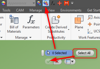

I selected the 'realistic style' on the appearance ribbon but when I go to change the appearance to a gradient as you said the whole part just remains a greyish colour no matter what scale or rotation I use which is strange. I tried the other method of using an image but I didn't have any luck with that either unfortunately

@bb20460 If this is an imported part, then maybe it helps if you clear all color overrides first.
Then apply the gradient color you made.

I don't think I am allowed to post the part because of the nature of the project however the teaching assistants are currently unavailable so asking for advice in a forum seems reasonable. I attached a photo of what the part currently looks like when I apply a gradient and the settings I am using. It is a lofted feature between several work planes so I am not sure if that makes the solution any different as I have been trying to do this for some time now.

It was something simple! All the settings that I had were correct but I had the textures turned off for some reason which stopped the gradients being displayed and was just giving me a flat colour.
