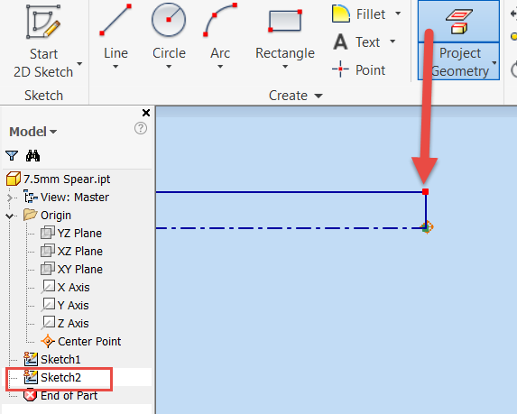

Start a new part file.
Create the sketch exactly as shown below.
(Use the Rectangle tool.  Right click on the horizontal line at the origin and change to Centerline.  Add the Ø7.5 diametral dimension.)
To the left side of the rectangle - add these two lines and 3 dimensions as shown.
Exit sketching mode and save the file.
Message 18 of 48
JDMather
Right click on Sketch1 in the browser and unselect Dimension Visibility.  This will clean up the screen for Sketch2.
Start a new Sketch on the XY plane.
Project Geometry the point on the rectangle shown (I project only the geometry that I need).
Message 19 of 48
JDMather
In Sketch2 add the Rectangle dimensioned as shown.
Finish Sketch2 by adding the two circles with the dimensions shown.
Message 20 of 48
JDMather
Drag the red End of Part marker above Sketch2.
We can move back and forth through history by dragging the red EOP marker.
Revolve the appropriate selected contour of Sketch1.
Drag the red EOP below Sketch2 and Extrude-Cut through all Symmetrically the Rectangle and two Circles.
