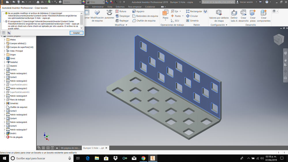

I can not make any changes to the piece. (previously if you let me modify the piece) also that message appears with all the pieces that I have in the folder. Autodesk Inventor Professional 2019error.png

Hi! Is it possible in the project setting, the folder where the ipt file is located is a library folder? Go to Get Started -> Project  -> Library. Is the part in a library folder? If you still want to edit it, either move it out of the folder. Or, you create a uber project covering the library under \Workspace\.
Many thanks!
