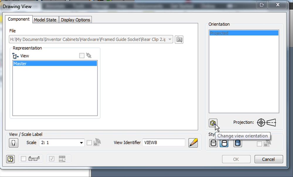

In Inventor 2013 when you would right click on a projected view of a part, the window that came up had a little cube you could click on and rotate the angle of view by a variable angle in all 3 planes. Inventor 2016 does not have that option to rotate the angle of view in my .idw. Is there a way I can rotate my view angle in 2016? I used to be able to do up my .idw and make my vie angle match previously drawn dws's in Autocad (these are catalog line drawings), and now I can't do that anymore. There has to be an easy answer, I can't imagine they would remove this option.

tmarrazzo
The top one is the first screen you get when you right click on the view and choose edit view. The second one is the screen you get when you click the change view orientation icon that is what you see on the first shot. This allows you to choose the degrees of rotation and which plane you are rotating. That Icon is not on 2016.

JDMather
In Post #3 you are entering from the drawing environment, now in the latest image you are in the modeling environment.

tmarrazzo
Double clicking on the view did it, thank you!!!!!! I will play with it some more.
