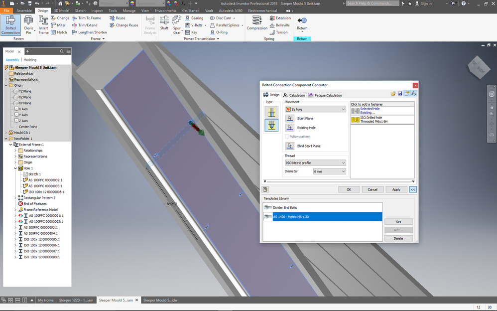

Following on from that.... Now with using the hole method and wanting to follow a patterned hole set, why is it that the following doesnt work? ie follow pattern is greyed out?
mwesse
Also, if the sketch is in with the frame ie as per pic, why isnt that available as points for bolts?
Xun.Zhang
Hi @mwesse,
Regard to the pattern problem, it also request a part level hole feature pattern rather than assembly hole pattern.
Refer to below video.
Xun
Xun.Zhang
Hi @mwesse,
If you talking about "Sketch 1" in your image, it is an assembly sketch. If you talking about sketch "Frame model reference", it is a 3D sketch. so that's the reason why you can't reuse them.
Hope it helps!
Xun
mwesse
Specifically the frame sketch...but it makes sense now. Thanks so very much
