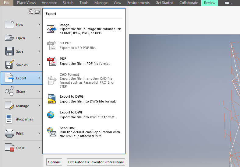

Is it possible to export to 3D PDF in the student version of Inventor Professional 2019? The option seems to be greyed out for me.
inventor.pngThank you.

Hi! Based on the ribbon panels, it looks like you have a drawing file opened. 3D PDF can only be exported from an assembly or a part.
