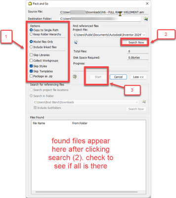

File > Save As Expand arrow:
Choose desired settings on the left, Click the "Search now" to find files

EagleBee93
After I complete step 2 of the pack and go, the "Start" button is still grayed out, even after it found all the files.
Message 16 of 17
EagleBee93
do i need to select "package as .zip" as well?
Message 17 of 17
blandb
Without seeing it I'm not sure. You can either choose to do the zip now, or investigate what it made and clean up the folder first, then zip it later. That's up to you.
