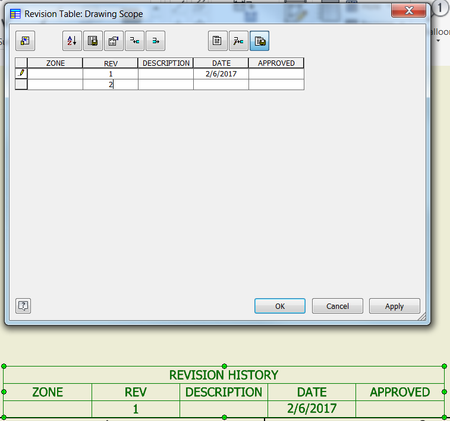

What I am trying to do is have my revision table snap its bottom line to the bottom line of my drawing sheet, and automaticly add rows by pushing everything up, keeping the latest revision at the bottom. Currently, if I place my table, to snap on the bottom line, and add a revision, it adds a row below my sheet limit, requiring me to move my table back up and resnap it. I've tried playing with all the options in style editor, but nothing seems to be working.
If there is a work around or if I missed something simple I'dd appreciate if you could help me.
Thank you

No, you can only have the "Header" stick to the border. You can change the direction. I would have to check my drafting standards as to which standard is covered by this.

Alright ty for the answer, guess I will just have to manually move it for this project.

Hi Dom,
There is a way to achieve this as following:
1. Double click a review table to open the dialog.
2. Click on the "Table Layout" button to open Table Layout dialog.
3. Change the direction to "Top"
4. Add new rows one by one. The new row will appear to top by order. And the table bottom will not change.
5. Then Change the Direction to "Bottom" and the table rows will be reversed as you expected.

"Heading" will move "Revision Table" header from top to bottom, and the "Direction" will add rows
