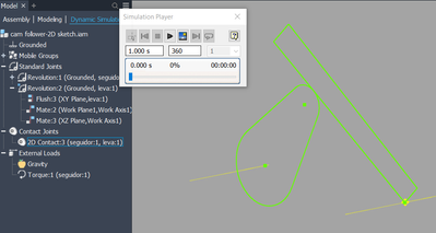

Hello, I attach an easy sketch. I pretend draw a CAM Follower on 2D Sketch like in Solidworks:
https://www.youtube.com/watch?v=DD8WeDyfOsA
but in Inventor I don't see any command like "make a path" like in SW.
I need tangent the cam-follower  on the entire path of the cam.
Can you help me??

JDMather
@pauinch85
First - your follower is very poorly designed.
Second - you have a tangent between one arc and one line - but you cam is actually two arcs and two lines.
Back in a moment with corrected solution...
JDMather
Open the Attached assembly file.
Go to Environments>Dynamic Simulation.
Note the 2D Contact Joint...
Click the Play button.
I had to create an assembly for this particular action, but for many mechanisms you can do directly with Blocks in part file as shown in the SolidWorks video.  This mechanism just happens to be special case because the follower can leave the cam without a Torque value (or Spring) to hold it against the cam. (Just like in the real world.)
