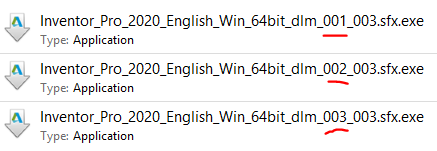

I have seen this issue and now know what to look for.
When you are downloading, depending on what browser you are using - there should be a progress "bar".
As @WHolzwarth implies, expand that download progress window and in my experience when Part 1 is completed, it does not automatically progress to Part 2 and 3 - I have to manually select these.
I wish I had a screen capture of what I am referring to as it can be a hidden step.
Later today I might go through the process just to grab that screen.
What browser are you using?
I assume that you know that in the end you need these three files.

Thank you @JDMather  @WHolzwarth
Appreciate the help from you both.
I have Inventor 2020 downloaded now.
