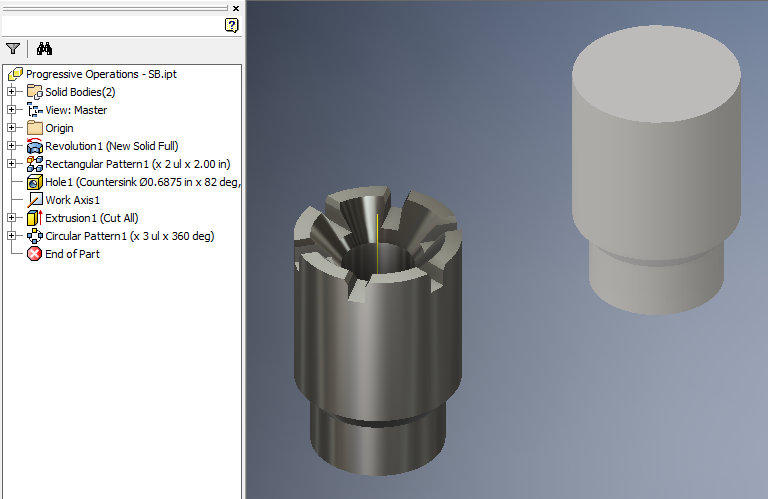

Adding on to what @Marco.Takx wrote, I would pattern your base part (turning details) a convenient distance away in the same file, making sure to select the New Solid button.  Then add the further machining details to your second solid.  All is in one file, but changes made before the Pattern feature affect both solids, changes after the Pattern feature to the machining details affect only that solid.  Then use View Representations to show them individually in a drawing.
This can also be extended to a third, fourth, etc. pattern to show as many stages in the fabrication process as you wish.
Here's what my test part and browser look like, with the (2016) part attached.

WHolzwarth
At first glance this looked like a good idea to me, Sam.
But aren't there problems with mass properties and placing this part in an IAM?
Walter
Walter Holzwarth
Message 6 of 9
SBix26
You're correct, Walter.  This works well for design and documentation, but you still need to derive one of the solids (presumably the last one) into a separate part for assembly purposes.  I'm not clear why @Anonymous (the OP) refuses to use linked parts-- seems to be deliberately removing a very powerful tool from their toolbox.
