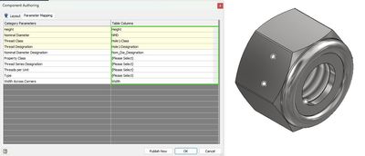

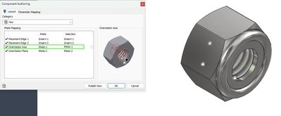

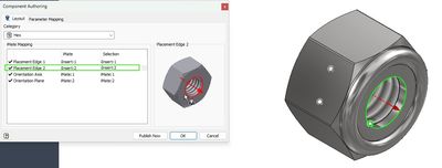

I've just successfully created Metric-Nylock Nut on Autodesk inventor which can be utilized on Bolted Connection in Assembly features
Just additional step from @jan_priban post above.
-setup a user parameter NMD (for example) and insert the number 4 (for M4).
-then ipart, ensure you have those items, I found NMD and Nom_Dia_Designation are required, number need to be adjusted to Nut Size anyway. I found it with "M" and without "M" will affect the process
-next, follow Component Authoring as per pictures and make sure those parameter from ipart are mapped.
 1 Parameter1 Parameter2 ipart author2 ipart author3 Component Authoring (a)3 Component Authoring (a)3 Component Authoring (b)3 Component Authoring (b)3 Componenr Authoring (c).jpg3 Componenr Authoring (d).jpg3 Componenr Authoring (e).jpg
