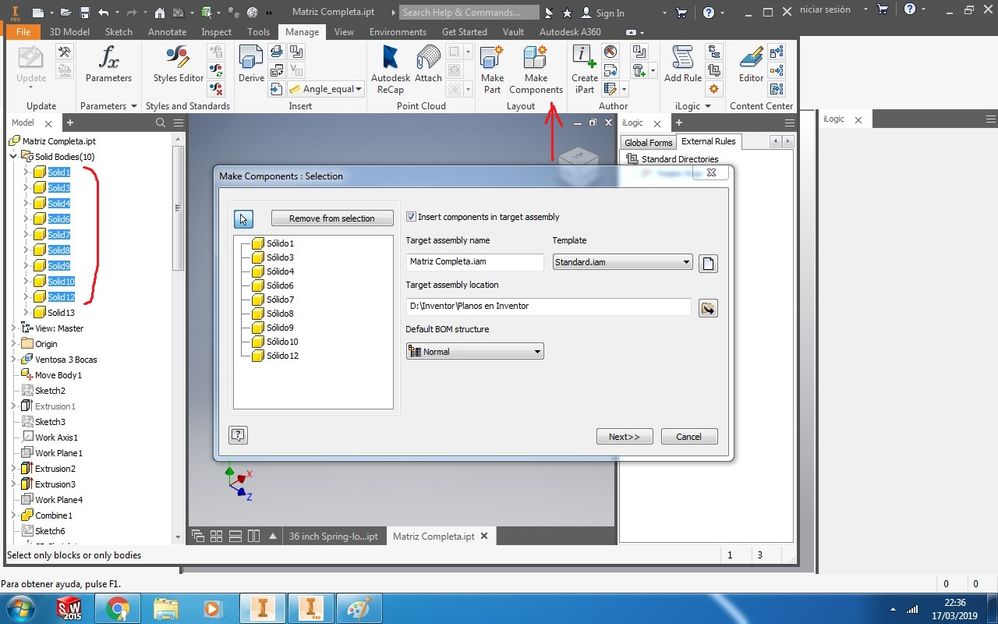

Another way would be to model a multibody, create a part file, where each solid within represents each part of your assembly (recommended for assembly of not many parts and where the parts are not repetitive) and once the assembly is complete, create new ones components from the solids generated in the file. (It is known as muscle modeling)

In each of these examples if they are well formulated you can change a parameter in one piece and the rest of the dependent pieces will be updated observing the respective changes
