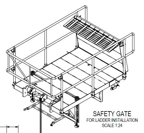

How long does it take to set up the bottom up design (please see the Rack Size. jpeg)? The end product is shown in 02-ga. jpeg. By changing parameters in master file - the whole model updates as expected. And drawings too. No crashes, no major rework due to the "sick constrains" is needed.
As a matter of fact - I always change some dimensions in the Master file after I am done with modeling. Just to see, that all parts are linked together properly. Once I am satisfied with the result -  I change the dimensions back to what it should be. It is fun to watch - how it all gets updated.

Message 12 of 27
IB55
I have to agree with IgorMir.
Bottom-up design for the assembly which will have 200-300 unique parts and around 3000 occurrences will take much, much longer than Top-down method. More importantly to make quick changes in to the design without issues will be almost impossible. And this changes can be anything: to satisfy requirements from architect, structural engineer, fabricator, main contractor, other interfacing trades.
Bringing Vault subject in this topic is absolutely irrelevant. There are no library items used in this design and not a single part will be reused in any future projects. Therefore is nothing to publish for re-use. It would be different if the work is in manufacturing industry where serial production of similar or identical products is the key. In construction is very opposite: I have not yet met any architects who wants to replicate existing design.

Through the use of libraries and copy design, we make industrial washers bespoke to client specification. Conveyors and everything repeatable becomes iFactory powered and we can adjust size on tables or, like I said, simply copy design and modify a few things here and there.
I understand that if you have projects that never repeat in likeliness you can model those faster through top-down design, but over time any company should compose a library of components and assemblies. This is how Inventor Factory also works, even leveraging components from 2D AutoCAD.
You can show me all day how to model an individual assembly is faster in top-down, but having to re-generate most components using Derive should take longer over multiple projects.

Below is an example of a project (not architectural) that I did where nearly every part is a vendor part I authored in the CC. Took about 4 hours to get them all authored, but that accounted for only a small % of the time from start to finish. All the parts are used on docks and water-side access equipment (by EMS - aluminum extrusions supplier). There's pipe and tube (easy to convert existing CC), L, U, I, misc sections, FB, RB, fittings, etc. Lots of different shapes and sizes! I included in the profile only as much detail as needed for dimensional purposes. So for example, the doc deck planks have raised ribs across them. I didn't detail that b/c it would eat up computer resources. i just modeled the part to the top surface of the ridges to keep it simple.
There's a very lengthy discussion on this forum about structural work. It began around 2010. The guy worked w/his company to create structural parts and assemblies that they could 'pick-n-place' to get structural work done. I've not achieved that level of process yet, but have been trying for years. That's why I'm trying to learn VB.Net, to do that kind of thing. I'm betting you could achieve some of that with architectural millwork, esp. if you have AutoCAD 2d drawings to work from.
