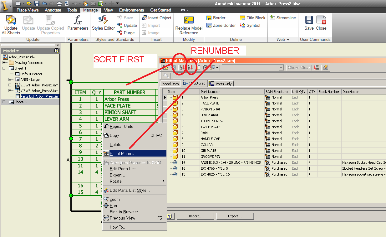

To keep everything in order it is best to renumber the item numbers in the assembly BOM.
RMB on the part list and click Bill of Materials.
Sort as desired.
Then click renumber.
This won't order to balloon drawing position unless you sort the parts to match.
The part list drives the balloons.
If you overwrite the balloons to the required position then RMB on the part list you can Save overrides to BOM, this will make things line up once again.

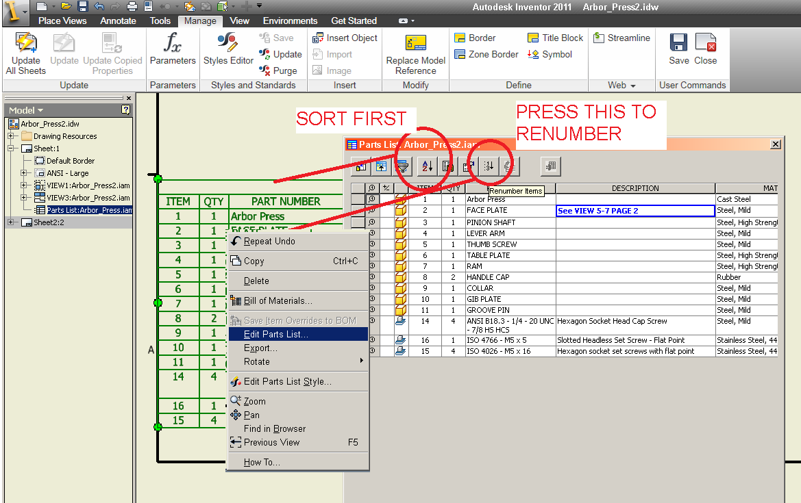

You can renumber in the part list but they will become overwritten values shown by blue cells.
There may be times you want this but remember they won't match the assembly BOM or part lists in other drawings.
