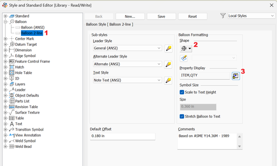

Is there a way to stack (subscipt/superscript) the text in a balloon?
I know how to stack text in leade text, but I don't know if it is possible in text inside balloon.

I was able to add subscript to a balloon. Give this a try and let me know if it meets your need.
In an ipt, I went into iproperties to the custom tab and added a field I titled "SUBSCRIPT". However, this can also be done to any other Inventor component filetype.

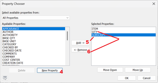

In an idw template, I went into Style Manager and added a Bubble style I called Balloon 2-Line. I then went over the the Balloon Formatting field and chose Circular - 2 Entries. By default, the Property Display is "ITEM,QTY". However, that can be changed by clicking on the Property Chooser button. In Property Chooser, create New Property "SUBSCRIPT", add "SUBSCRIPT", and Remove "QTY".
