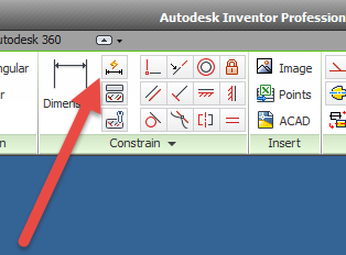

Whenever I have a problem to make a sketch fully constrained I use this button to constrain a sketch fully. So far it has not failed. I wish to know whether it is advisable to use this button. Help topic has very limited information about what I need.

JDMather
Forget that you ever saw that button.
Drag points and figure out what is needed.
Then you will no longer have this issue as you will have learned how to properly dimension and constrain a sketch.

mcgyvr
I believe its always best to manually dimension and constrain (any constraints that aren't automatically inferred already) everything yourself.
But I have used that button a few times..
I would never recommend a new user presses that button..

I don't use the automatic constraint/dimension button.
Instead I use the following:
  1. Project geometry that I need from the model origin or previous features.  Keep this to a minimum.
  2. Draw the sketch geometry that I need.
  3. Confirm the automatic sketch constraints and add new ones as required.
  4. Add dimensions to control the geometry.
Each step requires thought about my design goals, manufacturing requirements, company standards, how I expect the sketch to change as my design evolves over time, and how to structure the web of geometry, constraints and dimensions so that someone else can understand my model at a glance.  You will get better at considering all these factors as you gain experience with the tools.  I use a similar set of factors as I place and constrain components into assemblies.
I don't use the automatic constraint/dimension tool because it has no knowledge about all the above factors.
Look for the "Show All Degrees of Freedom" command from the Right Mouse Button menu while in a sketch.  That will show you the remaining DOF in your sketches and give you some direction for additional dimensions and sketch constraints.

tschaeferZNBXX
I have NEVER used that button and STRONGLY advise you not to.  Using this button will make your life more difficult and hard to trouble shot any issues you have if the sketch gets sick.
If you understand the part you are make or sketch you are making there should be no need to use this button. It could add dims or constraints that mean nothing to your design but satisfy the criteria for a sketch to be fully constrained/dimensioned.

Use the Show All Degrees of Freedom tool or JD Mather's vertex drag suggestion to learn where you missed a dimension or constraint.  Once you know what geometry is under-constrained, add dimensions/constraints to tie it down.  Don't just slap a dimension on a line, think about how that dimension will be used later in the design process and the life of the product.

In the Automatic Dimension tool you can un-select the Dimensions check box and let it only put on only sketch constraints.
I do use it this way occasionally.
Like everyone else has said, I do not recommend using this tool as a matter of common practice. If you develop proper practices and good sketch and constraining skills the need to use this tool to apply constraints will only arise when trying to work with someone else's poorly sketched mess. Smiley Wink
In this picture it says 2 Dimensions required, but in reality it is 1 sketch constraint.
