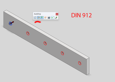

I was very happy about the fastener insert lock button in version 2032.2, but today I discovered that the button is missing when inserting countersunk fasteners. Is that how it was intended? I also noticed that if you insert fasteners with the "follow pattern" function, then you can grab the fastener to rotate the pattern around the axis. What's the point?

Works the same for me.  With countersunk (flat head) screws, Autodrop does not show the lock rotation button.  And, when using Follow Pattern, the whole pattern can be dragged around the primary member-- but it snaps right back where it belongs when it is released, so that doesn't seem like a real problem.
But the lack of a rotation lock control appears to be a bug.  I can't imagine a good reason for leaving it out.

1. Constraints: You are right, Follow Pattern does create iMate on first / master bolt only, but pattern as feature / group keeps its position. As was said above, you can rotate entire pattern but once you release rotating bolts pattern, bolts pattern jump to correct / original position
2. Lock Rotation: It depends what bolt type you are placing / AutoDroping. If you place "regular" bolt like DIN 6921 that has regular head then under head there is created iMate of type INSERT. This INSERT type has option LOCK ROTATION.
While placing countersunk bolt like DIN 7991, usually being placed into countersink hole, creates iMate type MATE (conical face to conical face). MATE does not support lock rotation. It is iMates types Inventor naturality.
