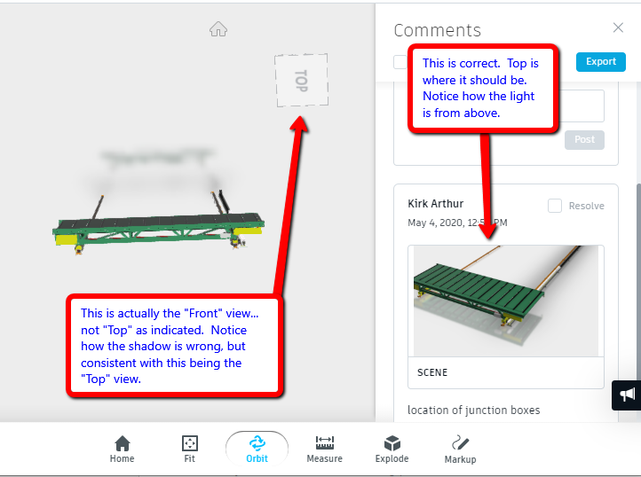

karthur1
No.  The top view for the shared view does not match Inventor.  I just deleted the shared view and recreated it.
This is what the top view looks like in Inventor.
This is what the Shared view looks like.  Not even close.
I do see this when I open the shared view. But when I click on it, the log is showing some missing .bmp files.  I dont think that would have anything to do with the view orientation.
