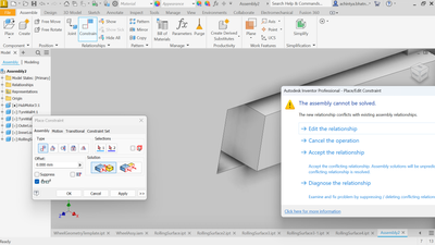

I have an assembly of a wheel. I have grounded the central hub. I have few other circular parts that are coaxial with the hub. I was able to align their axes and also prevent their axial movement -- both by placing Mate Mate Assembly Constraints. However, I am unable to make them stop rotating with respect to each other.
I need to align slots in one part with the teeth in the other part, both of which are mounted on the wheel hub, so that all the three parts are rigidly connected with each other.
Could you please suggest how to achieve this?
Attached is my assembly file and a picture. Thank you.

achintya_bhatnagar
@Alexander_Chernikov @kacper.suchomski
I tried using constraints, but adding constraints to link rotation generates errors. See the screenshot here.
I have tried almost everything I could think off. It is still not working. Please see the assembly and part files attached here. I need to not only lock the relative rotational motion but also ensure that the teeth fit into slots.

kacper.suchomski
  1. The cutouts are rectangular (parallel sides); and the plugs are radial (angled sides). How did you try to align them while maintaining concentricity? (This is a geometry question, not Inventor).
  2. You don't read the advice carefully. @Alexander_Chernikov  and I both wrote to use mate/parallel or angular constraints to the construction planes of the individual components, not the faces of the grooves. And after seeing the model, this advice still holds true. And it works.

Hi! I think you want to make sure TyreWall4:1, TyreWall4:2, and RollingSurface4:1 rotate synchronously, right? If yes, the constraints to use are Mate or Flush to ensure one of their origin planes are aligned.

Thank you all for your help. My problem has been solved. In summary, the parts can be locked for rotation in this way:
Place the assembly angle constraint (choose undirected angles) between the workplanes of the parts. For selecting the workplanes, on the left in the browser window, open one of the parts, go to Origin and select one of the planes (XY, YZ or XZ). Then do the same thing again for the other part.
For aligning the plugs with the cutouts, create a new plane as explained by @89198826955 above.
