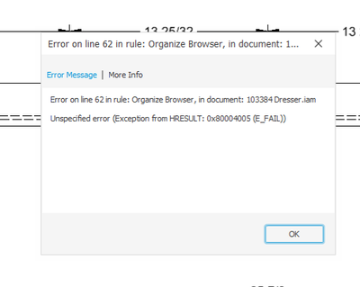

I have never seen Woodwork create any folders that I am aware of. The folder in question is actually created by an iLogic code we have used for the last 5 years to help clean up our browser. This is in our assembly template file that everyone in our department uses. The code has been reviewed by several people during this investigation and nothing specific has jumped out. I will attach the code in an .txt document for review.
One thing that does make sense is at the beginning we were getting the below pop up during a save, and this was usually a precursor to the assembly being corrupted next time it opened. This pop-up stopped happening after the computer change or is inconsistent at best to show itself.

I did suspect that line of code when I looked at it in your "good" dataset, but I discarded the thought because the script is iterating over the occurrences and checking to see if its a library path. I would not expect that to come back with any browser node other that of an occurrence.
You could do test each node coming back and throw a message box or error to see if the problem happens.
Something like:
   If oNode.Type is kBrowserObjectType
   MessageBox.Show("Error: Unexpected node type found")
Btw, I did try running the script several times and it works with the good dataset you sent me. So, still puzzled.
