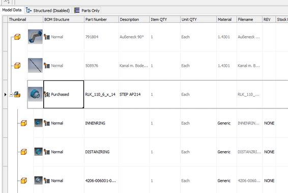

For example I am sharing below two images.
Please check in first Image I declared  RLK_110_6_x_14 assembly as a purchased Item under Model data rab
Now it showing only assembly and not child parts as shown below under part tab
I hope it will help you to solve your problem.

Open the OEM assembly.
In document settings, BOM, set it to "Purchased".
Message 4 of 8
johnsonshiue
Hi! Or, set it to Inseperable.

I think there are two issues & the second (not so obvious) is causing the confusion.
Setting the OEM assembly to "Purchased" (Tools>Document Setting>Bill of Materials) & then any parts within that assembly to "Normal" (right click in Assembly Tree>BOM Structure) sorted one of the issues.
