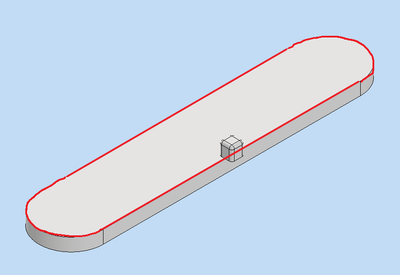

Hi experts,
How to use array around the line?
like the red line.
Because entering drawing environment, and project that line.
It can't click the line.
Thanks!

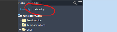

how do you show  rectangular pattern below BODY:1 ?
BDCollett
@francischen wrote:
Thanks for your reply.
Using Inventor2021
but i reference your model, and try again.
You need to be on the Modeling tab as highlighted in their example above.
