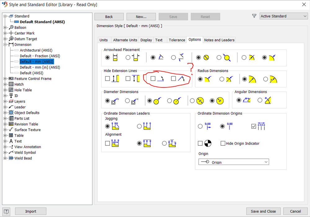

Object Defaults is more of a main index of what style types you have chosen under a Standard.
If you go to the desired dimension style (active standard or the one your Standard is using), there is a tab for "Options" where I am guessing you can alter/hide extension lines for radial dimensions.... I'm not sure what you're looking for though. I hope that's right, or can you post a screenshot of a sample drawn on Paint/etc. with what your intent is, perhaps?

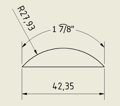

Hi @infoW9XPC
Did you mean something like this?
Message 5 of 12
infoW9XPC
Yes. So when the default standard is used the dimensions are in decimal format before making any changes like your radius and length dimension there. You can change that to the architectural style once you've placed the dimension.

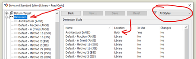

Arc length use linear dimension style, but you don't need to change style, just use Architectual ANSI.
1. Open Styles Editor (Manage tab)
2. Choose All Styles, and select dimensions
3. Select Architectual ANSI, do right click and choose Save in document
4. Now Location for this dimension style is Both
5. Create Arc length dimension
6. Select Arc lenght dimension and change style from Annotate -> Format

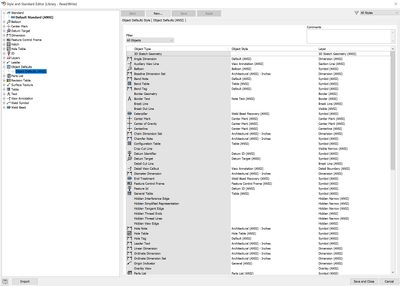

The problem is that I have to input a dimension, close out the dimension tool, select the dimension (or dimensions), click the drop-down menu, then select the style I want. If I am able to change the the object style then it will save 4 of the 5 steps.
I may still not be understanding your meaning correctly, but you can automatically change the default style based on dimension type through the Object Default selections. I have done this and it works correctly so that when I input a linear dimension it's automatically in the style I want (same for radius, diameter, etc.). I have a screenshot attached of that menu.
But arc length is missing from that menu, and I don't see why. If arc length style is included as a part of another object style I haven't been able to find where that would be either.
