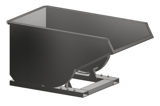

Although  I did not intend for the skip to drag along the base. A later screenshot of the model shows the locating teeth.
