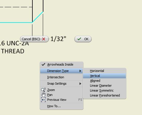

         I am trying to do an aligned dimension from these two points, but no matter what I do it wont go in the direction that I need. Not horizontal or vertical dimension. Any advice?Capture.PNG

After you pick the two points and before you place the dimension, RC and you should get this menu that will allow you place a vertical or horizontal dimension.
check.PNGIf this solved your issue please mark this posting "Accept as Solution".

I'm guessing you want the dim at the same alignment at the 2.4 or 4 dimension? If so, try to use Baseline or Chain dimension instead of a plain Dimension.

If you want to align it to the 2.4 or 4.0 dimension direction, you can use Chain dimension. Select the direction line first then the two points. It takes a little effort to align the dimension to the direction. Remove the unwanted dimensions at last.
Please let me know whether this is what you want.
