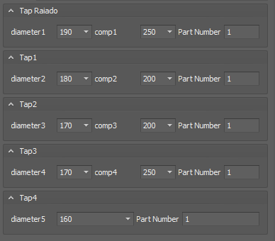

Again came here for some help. I want to add one or two column in i-logic form interface. For your reference i have added image. Please have a look and give me some suggestion on this.

Hello Kanagavel,
I totally understand what you mean, but I´m afraid the iLogic is very limited in styling the interface. I´m having the same issue that I can´t add multiple columns next to each other with titles above them like you can in Excel.
The only thing you can do is make a splitter with the toolbox of iLogic. But that only works for horizontal splitting.
If you have another solution, let me know aswell 🙂

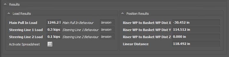

You may also try, if you haven't already, adding rows:
Question, are you wanting these to somehow populate the same parameters? Won't they have there own cells? IF so, then yes, the guy showing the Dark theme is correct for you... 🙂

There is a way to associate a dimension after the part number shows the form how this picture?
johnsonshiue
Hi! You are trying to make a dimension become part of the Part Number? If yes, it is doable with or without iLogic. Please share your attempt here. Forum experts can help take a look and provide further guidance.

Yes, I'm trying to do this dimension to turn in link the BOM and show the part number form automatically, look how I did,  I don't like it but didn't  link
