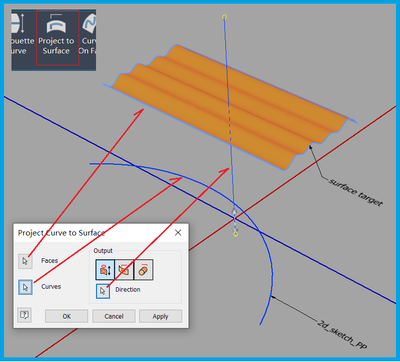

Basic situation of the scene########################
Method_1 ###############################
Method_2 ###############################
My Questions ###############################
Q1-------------------------------------
R_001=the relationship that you build between the source (FF)and the product(KK)by method one
R_002=the relationship that you build between the source (PP)and the product (WW)by method two
What is the essential difference between R_001 and R_002, and are they equivalentCan anyone make a list of the differences?

Hi! These are very interesting questions. Let me explain the major difference between the two. The first one is projecting all the sketch geometry from the given 2D Sketch to a new 3D Sketch. Any new sketch geometry added to the 2D Sketch will automatically project to the same 3D Sketch. It is like the 3D Sketch is linked to the 2D Sketch.
The second method offers more atomic level control. You need to select a curve in the 2D Sketch to project (as opposed to entire 2D Sketch).
You may consider the first method automating the process in the second method. To break the link between the 3D Sketch and the 2D Sketch (method 1), you may right-click on the "Project from Sketch" icon in the browser -> Break link.
Many thanks!
