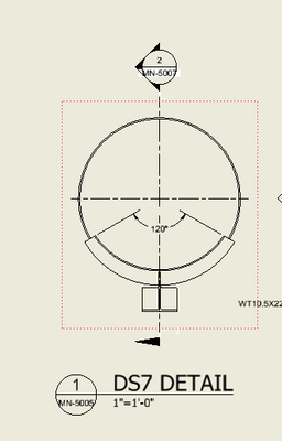

ABILITY TO CREATE A CUSTOM VIEW SECTION DETAILS AND VIEW LABELS
matt.eschman
FOR VIEW LABELS I NEED OPTION TO ADD OBJECT SUCH AS A CIRCLE OR BUBBLE.
FOR SECTION I NEED OPTION TO ADD SYMBOLS OR DIFFERENT ARROWS AND A CIRCLE OR BUBBLE WITH SHEET REF.

matt.eschman
I am using sketch symbols now but is a bit time consuming. I need the view label with the circle on front as well and I am using sketch symbol but if view referenced is change I have to manually change the view label sketch symbol.
johnsonshiue
Hi Matt,
I believe I have seen similar requests before. I don't think the desirable workflow is enabled yet. Currently the view labels only allows the label text or the standard linetype to be configured.

A.Acheson
Hi @matt.eschman
As @johnsonshiue suggest these detailing tools are not really available which is a shame. There might be ways to drive symbol info through ilogic/ vba macro but it will be a tricky one as to try and connect the symbol leader to the view in order to ensure your changing the right one can be difficult. Very easy when selecting it manually as your eyes are a great tool. Can you give more info as to where the info is coming from and in what way it needs to change? This isn't totally clear from your drawing image.
