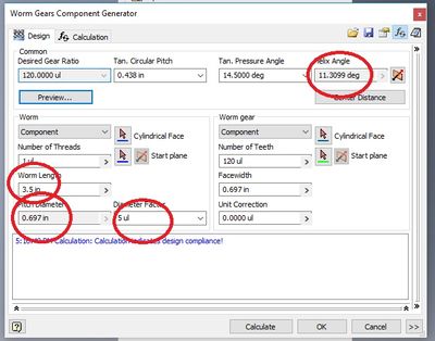

What are the magic numbers to enter in the generator to create the following 32 dp worm gear and worm?
Gear:
120 teeth
14.5° pressure angle
4.08° lead angle
3.75" pitch diameter
Worm:
4.08° lead angle
0.438" Pitch Diameter

I'm far from a gear expert but here are two solutions:
Forcing helix angle
Forcing Pitch Diameter
PDSU 2016
etfrench
Well, those are solutions, but neither is anywhere close to correct. Smiley Sad  I've tried manipulating all of the various settings and I can only get either the helix angle or the worm pitch diameter correct.  Never both at the same time.   The closest I've come is using metric settings instead of imperial.
I need to make the gear to match a purchased worm, so all of the parameters must be correct.
