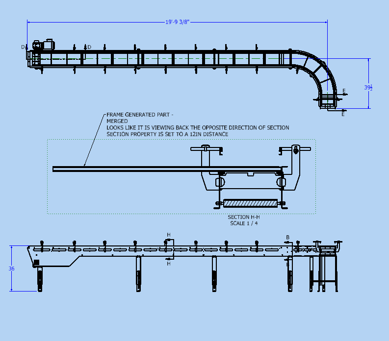

Hey all I'm having trouble sectioning my drawing properly. It was fine until I started adding the frame generated parts. See below pic. Any section I create is the same.
SECTION PROBLEMSECTION PROBLEM

See if the attached thread helps you.
https://forums.autodesk.com/t5/inventor-forum/part-not-displaying-correctly-in-drawing/m-p/3120798#M...

jnewon
Thanks for the link but no luck...
I unchecked the background update on the drawing tab in options dialog... I then selected the view... The update lightning bolt came on..  I updated.. Nothing...
The section is viewing the whole FG part regardless of direction and section distance.
This FG part does follow a curve but in my mind it should be like any other curved part in this model
It seems to work if I make a detail of the area and then section the detail. Or I section another section
The question is why can't I section the assembly directly?

Section Participation...
Tools > Application Options > Drawing >Section Standard Parts > Always. You could control the components individually in the browser, but this will do all by default.

jnewon
Thanks. That worked.
