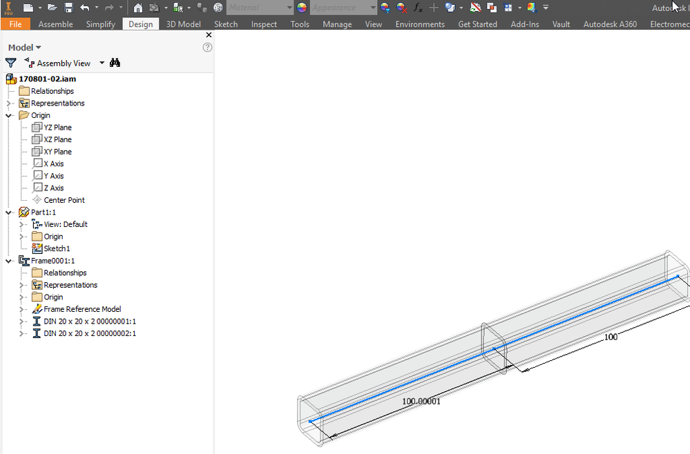

Seems to be working on 2017...
It's not related to which part in insert first. I have created a new simulation where I insert a "100mm" member then add one of "100.00001mm" and it still works

2017 doesn't allow dimension display precision (Document Settings > Units > Linear Dim Display Precision) to be set more than five decimal places.  The problem occurs only in 2018, which allows that setting up to eight places.
