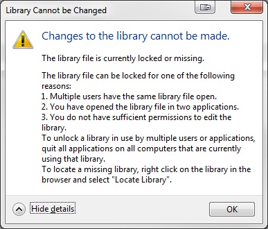

Rory_M
Hopefully I'm missing a trick here, but is the ability to add materials to the library whilst others are working now gone?
I've set up a materials library which is stored on the server. We all have it referenced in our project files so it's a shared resource.
I'm trying to add a new material to it, and get this message:
Is this right?
The main point is that it states that "Multiple users have the same library file open" and "Quit all applications on all computers that are currently using that library".
Surely the point of a library is so that everyone accesses the same data. I don't like the idea of having to have a library for each user so that we can add or edit materials without logging everyone out.
If this is correct then this is a major problem. Please let me know if there is a setting I'm missing or a workaround that doesn't involve everyone shutting down Inventor.
Rory

JorgenBjornes
I acually just stumbled upon this. Materials cannot be added anymore due to the material file being read by another computer.
Because the first Inventor started holds read-access to the material file (which is placed in a network share together with the rest of the style library)..
Really...
This will become a major pain factor, making editing/adding materials virtually impossible unless I'm the first one to show up at the office in the morning.
-This must surely be a bug to be quickly fixed in a hotfix??
-Any good known workarounds?
Message 34 of 94
mrattray
I have.this problem with the default.ivb file. It lives in a shared network folder and the first person in in the morning gets read/write (very rarely is that me). I ended up setting it to read only. It's fine except if I want to make a change I have to shut down my IV, set it to not read only, restart IV, make my changes, shut down IV, check it read only and then restart IV again. Still, it's better then trying to figure out who in the office has the magic key and convincing them to stop working so I can make a tweek to a macro.
Mike (not Matt) Rattray
