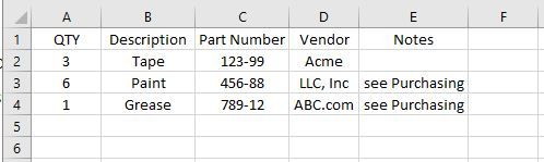

Give this version a try, it uses the QTY specified in the Excel file.
Note that as written the virtual components are all deleted first, then put back in based on what is in the Excel file.
So if there is a qty of zero in the Excel file the virtual part is removed if it existed. And if the virtual part is not in the Excel file but is in the assembly, the virtual part will be removed and not added back.
I hope this helps.
Curtis

Give this a try... note I put in some status bar lines to let the user know the rule was doing work... on my system at least the reading of the XLS file is kinda slow and it made it seem as if it was freezing up, so the status bar helps communicate that things are happening, but it's not really needed for the rule to work.
I hope this helps.
Curtis

	If  iQTY >= 1 Then
		virtOcc = occs.AddVirtual(sVirtPart, identity)
		Try
		iProperties.Value(sVirtPart & ":1", "Project", "Description") = oProp1
		Catch 'catch error when oProp1 = nothing
		End Try
		Try
		iProperties.Value(sVirtPart & ":1", "Project", "Part Number") = oProp2
		Catch 'catch error when oProp2 = nothing
		End Try
		Try
		iProperties.Value(sVirtPart & ":1", "Project", "Vendor") = oProp3
		Catch 'catch error when oProp4 = nothing
		End Try
		Try
		iProperties.Value(sVirtPart & ":1", "Summary", "Comments") = oProp4
		Catch 'catch error when oProp5 = nothing
		End Try
	End If
	'add next instance starting at instance2 (if applicable)
	Dim index As Integer
	index = 2
	Do While index <= iQTY
		occs.AddByComponentDefinition(virtOcc.Definition, identity)
		index += 1
	Loop
Next
'update the status bar
ThisApplication.StatusBarText = "Virtual components added!"

'Virtual Parts Excel Import
'based on a Curtis Waguespack rule (2019)
'[check that the active document is an assembly file
If ThisApplication.ActiveDocument.DocumentType <> kAssemblyDocumentObject Then
MessageBox.Show("Please run this rule from an assembly file.", "iLogic")
Exit Sub
End If
'[information
MessageBox.Show("This rule will read an Excel file of Virtual Parts and add them to the assembly." _
& vbLf & vbLf & "Use '$\Styles\MyCompany\iLogic\External Rules\Virtual Parts Excel Import Template.xlsx' as a template." _
& vbLf & vbLf & "Wait for Completed message.  It may take some time to finish.", "Virtual Parts Import", _
MessageBoxButtons.OK)
'[browse for the Excel file
oMsg = "Select a Virtual Parts Excel File"
ThisApplication.StatusBarText = oMsg
Dim oFileDlg As Inventor.FileDialog = Nothing
InventorVb.Application.CreateFileDialog(oFileDlg)
oFileDlg.Filter = "Excel Files (*.xls;*.xlsx)|*.xls;*.xlsx"
oFileDlg.DialogTitle = oMsg
oFileDlg.InitialDirectory = ThisDoc.Path
oFileDlg.CancelError = True
Try
	oFileDlg.ShowOpen()
Catch
	'catch error when no file is selected
	Return 'exit rule
End Try
If Err.Number <> 0 Then
	MessageBox.Show("A problem occured when getting the Excel file.", "iLogic",MessageBoxButtons.OK,MessageBoxIcon.Error)
	Return 'exit if file not selected
ElseIf oFileDlg.FileName <> "" Then
	myXLS  = oFileDlg.FileName
	'update the status bar with the Excel file name
	ThisApplication.StatusBarText = "...reading info from " & myXLS
End If
Dim MyArrayList As New ArrayList
MyArrayList = GoExcel.CellValues(myXLS, "Sheet1", "A2", "A500")
'define assembly
Dim asmDoc As AssemblyDocument
asmDoc = ThisApplication.ActiveDocument
'define assembly Component Definition
Dim oAsmCompDef As AssemblyComponentDefinition
oAsmCompDef = ThisApplication.ActiveDocument.ComponentDefinition
Dim occs As ComponentOccurrences
occs = asmDoc.ComponentDefinition.Occurrences
Dim identity As Matrix
identity = ThisApplication.TransientGeometry.CreateMatrix
Dim sVirtPart As String
'[get info from the XLS file
For MyRow = 2 To 500 'index row 2 through 500
    iQTY = GoExcel.CellValue("A" & MyRow) 'QTY
 	oProp1 = GoExcel.CellValue("B" & MyRow) 'Part Number
    oProp2 = GoExcel.CellValue("C" & MyRow) 'UOM
    oProp3 = GoExcel.CellValue("D" & MyRow) 'Description
    oProp4 = GoExcel.CellValue("E" & MyRow) 'Item Description
    oProp5 = GoExcel.CellValue("F" & MyRow) 'Has Drawing
    oProp6 = GoExcel.CellValue("G" & MyRow) 'Product Code
    oProp7 = GoExcel.CellValue("H" & MyRow) 'Spare Part
    oProp8 = GoExcel.CellValue("I" & MyRow) 'Critical Spare
    oProp9 = GoExcel.CellValue("J" & MyRow) 'Manufacturer
    oProp10 = GoExcel.CellValue("K" & MyRow) 'Source Code
	oProp11 = GoExcel.CellValue("L" & MyRow) 'MyCompany Supplied
	sVirtPart = oProp1 'defines the virtual part name
	'[Iterate through all of the occurrences in the assembly
	Dim asmOcc As ComponentOccurrence
	For Each asmOcc  In oAsmCompDef.Occurrences
		'get name of occurence only (sees only everything left of the colon)
		Dim oOcc As Object
		oOcc = asmOcc.Name.Split(":")(0)
		'look at only virtual components
		If TypeOf asmOcc.Definition Is VirtualComponentDefinition Then
			'compare name selected from list to the
			'existing virtual parts
			If oOcc = sVirtPart Then
				'delete existing virtual parts if name matches
				asmOcc.Delete
			End If
		End If
	Next
	'[create first instance of the virtual part
	Dim virtOcc As ComponentOccurrence
	If  iQTY >= 1 Then
		    Try
		    iProperties.Value(sVirtPart & ":1", "Project", "Part Number") = oProp1
                End Try
            Try
            iProperties.Value(sVirtPart & ":1", "Custom", "UOM") = oProp2
                End Try
            Try
            iProperties.Value(sVirtPart & ":1", "Project", "Description") = oProp3
                Catch 'catch error when oProp3 = nothing
                End Try
            Try
            iProperties.Value(sVirtPart & ":1", "Custom", "Item Description") = oProp4
                End Try
            Try
            iProperties.Value(sVirtPart & ":1", "Custom", "Has Drawing") = oProp5
                End Try
 			Try
            iProperties.Value(sVirtPart & ":1", "Custom", "Product Code") = oProp6
                Catch 'catch error when oProp6 = nothing
                End Try
			Try
            iProperties.Value(sVirtPart & ":1", "Custom", "Spare Part") = oProp7
                Catch 'catch error when oProp7 = nothing
                End Try
			Try
            iProperties.Value(sVirtPart & ":1", "Custom", "Critical Spare") = oProp8
                Catch 'catch error when oProp8 = nothing
                End Try
			Try
            iProperties.Value(sVirtPart & ":1", "Custom", "Manufacturer") = oProp9
                Catch 'catch error when oProp9 = nothing
                End Try
			Try
            iProperties.Value(sVirtPart & ":1", "Custom", "Source Code") = oProp10
                Catch 'catch error when oProp10 = nothing
                End Try
			Try
            iProperties.Value(sVirtPart & ":1", "Custom", "MyCompany Supplied") = oProp11
                Catch 'catch error when oProp11 = nothing
                End Try
	End If
	'[add next instance starting at instance2 (if applicable)
	index = 2
		index += 1
	Loop
Next
MessageBox.Show("Finished adding Virtual Parts to assembly!", "Completed")

'[ get info from the XLS file
'Define Range
oRowStart = 2
oRowEnd = 2000
Dim count As Double
For count = oRowStart To oRowEnd
	' If it's blank count it
	If String.IsNullOrEmpty(GoExcel.CellValue("A" & count)) Then
		i = i + 1
	End If
Next
' Next empty row is max rows minus blank rows plus one
oEmptyRow = oRowEnd - i + 1
'index row 2 through next empty row
For MyRow = 2 To oEmptyRow
__________________________________________________________
Product Design & Manufacturing Collection 2023 | Vault Professional 2023
Dell Precision 7670 | Intel i7-12850HX - 2100 Mhz - 64GB
nVIDIA RTX A3000 12GB | Windows 10/64 Pro
Message 17 of 25
Curtis_Waguespack
Hi @Greatwhitenorth ,
I think that empty row check solution was used to find the last used row, but would not find a row in the middle that was empty.
This example will return the first row with an empty A1 cell
myXLS = "C:\TEMP\Test.xlsx"
GoExcel.Open(myXLS, "Sheet1")
oRowStart = 2 'first row to check
oRowEnd = 2000 'last row to check
For i = oRowStart To oRowEnd
	If String.IsNullOrEmpty(GoExcel.CellValue("A" & i)) Then
		oEmptyRow = i
		Exit For
	End If
Next
MessageBox.Show("Fist Empty Row : " & oEmptyRow, "iLogic")
This one finds the first row with an empty cell for the first 6 cells in the that row
	oString = GoExcel.CellValue("A" & i) _
		& GoExcel.CellValue("B" & i) _
		& GoExcel.CellValue("C" & i) _
		& GoExcel.CellValue("D" & i) _
		& GoExcel.CellValue("E" & i) _
		& GoExcel.CellValue("F" & i)
	If String.IsNullOrEmpty(oString) Then
		'found a row with 6 empty cells so stop looking
		oEmptyRow = i
		Exit For
	End If
Next
        Try
        End Try
        Try
        End Try
        Try
        End Try
        Try
        End Try
    End If
    index = 2
        index += 1
    Loop
Next
Sean Farr
Product Designer at Teksign Inc.
Inventor 2016 SP1
Dell Precision 3660
i7-12700 @ 2.40GHz-4.90GHz
32GB DDR5 4400MHz RAM
NIVDIA RTX A2000 6GB
Message 20 of 25
e_frissell
@Curtis_Waguespack thanks for posting this script - however, if you don't mind, was wondering if you might be able to help with something I'm running into with this.
I'm trying to re-write this script such that the file selection is part of a try-catch where the try is initially searching in the folder path of the assembly for an xlsx file called "Virtual Parts" - if that file is not found, it then prompts the file dialog asking where to be pointed to.  The hard part is I'm not sure how to set up the variable myXLS to determine if no file exists or to open it simply from myXLS = ThisDoc.Path & "\Virtual Parts.xlsx"
Any recommendations?
