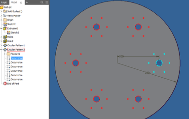

I have part - it's plate with multiple flanged connections. Basicaly it's circular pattern of holes. Each of these holes has few another smaller holes around itself (for bolts). So I create one hole with circular pattern of small holes around it and then create another circular pattern from them (one big hole + circ. pattern of small holes). As you can see in images below.
But when i use automated centerlines in drawing, only source features of the first pattern have centerline in desired orientation.
What I get.What I get.What I wantWhat I want
I know, that I can make these centerlines manually, but please NO! There are parts with hundreds of holes!

Hi! I am not aware of an automated way to create center patterns. You will need to use Center Pattern command to create the center marks. Please see the following Help document.
https://knowledge.autodesk.com/support/inventor-products/learn-explore/caas/CloudHelp/cloudhelp/2018...
Many thanks!

Thanks for advice. These are very bad news for me. Just now I have part with 20x8 and 24x10 holes (it's 180 and 284 clicks = crazy).
Is there way how to automate it with VBA?
I think about this approach (kind of pseudocode):
In SelectedView Do{
For i=0 to CirclePattern2.Element.Count -1 Do SelectTool("Centered Pattern"){ //Like click on the "Centered Pattern" icon CirclePattern2.Element[i].Hole2.Edge.Select //Select the big hole With Each Element In CirclePattern1 Do //For all small holes Element.Hole1.Edge.Select //Select the small hole End With Create //Confirm Centered pattern lines command } End For
But I have no Idea how to call the Centered pattern tool and address edges in VBA.
