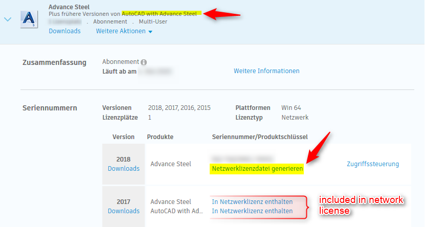

DarrenP
i think Autocad is looking for an Autocad license that is only for advance steel which Autocad will not use
is there more products in the license file?
DarrenP
Message 6 of 13
the Error is the same for AutoCAD and Advance Steel. Advance Steel needs AutoCAD to run an the license includes AutoCAD.
here is an example:
Message 7 of 13
